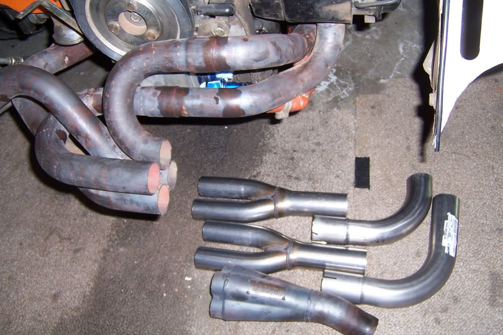

This is what happened first:

twin scroll :mrgreen: the good way to boost early with a big turbo :cheers: :cheers:
this is not for 1.2L :lol:

TurboR a écrit :twin scroll :mrgreen: the good way to boost early with a big turbo :cheers: :cheers:
++++++++ :cheers: :thumb:
