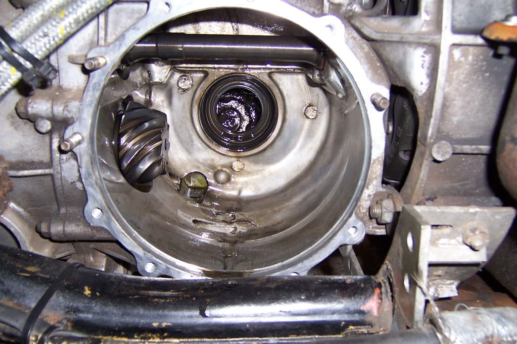

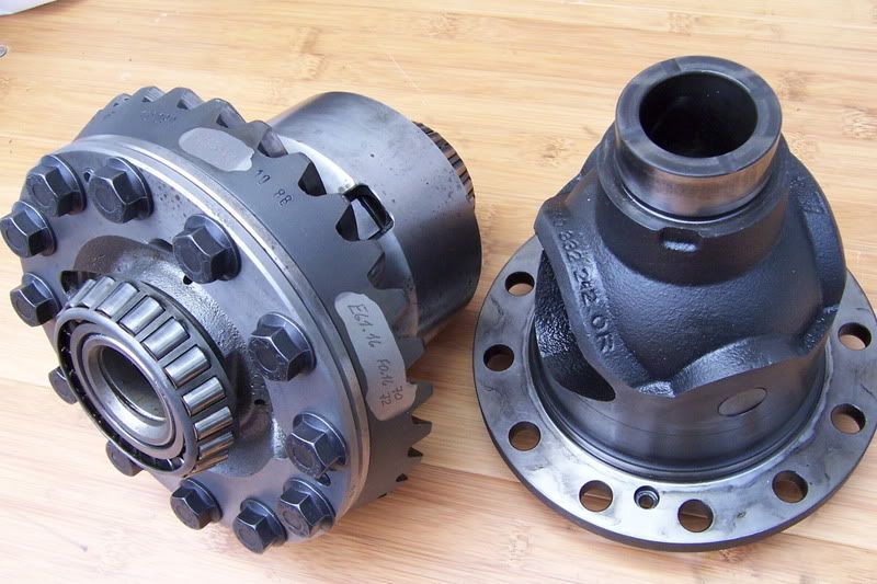

To utilise the power, a limited slip differential proved to be a good idea.
Diff taken out:
Left is the original but used 996 GT2/GT3 Porsche Motorsport 4-plate LSD, with now GT friction plates, which I am very happy with! Bearings and spacers put over to the 'new' diff with new but a bit longer bolts to bolt it to my old crown wheel :mrgreen:
Prochain dimanche, neuf 'track day' for the TimeAttack series I participate in with the 1303 :wink:
