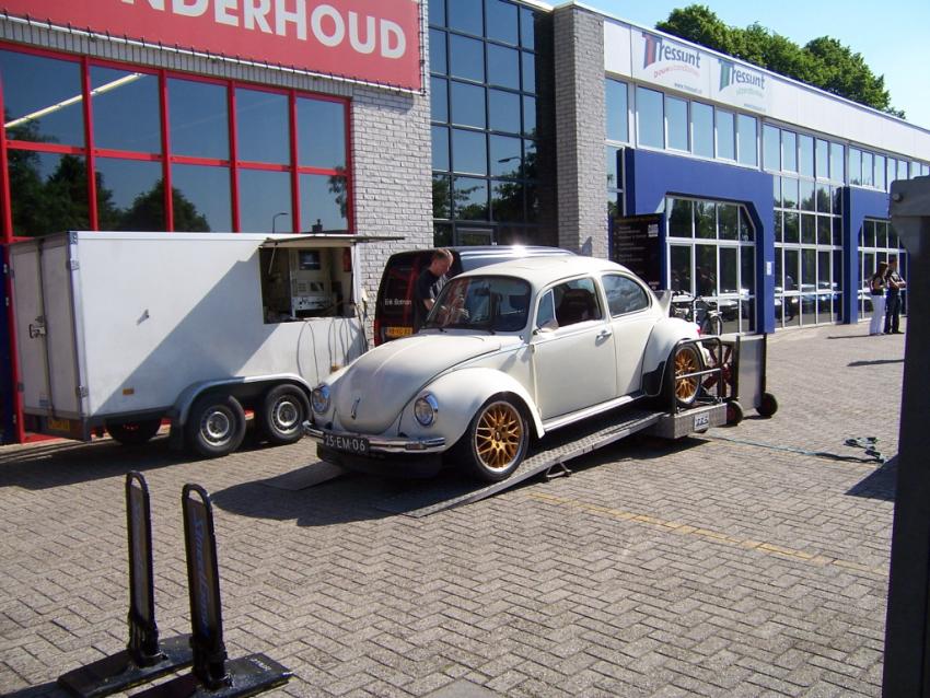

Tnx, I did dyno it on a mobile dyno the other day, but the conditions were not ideal and results were a bit diappointing: the were about the same as with the 2 ltr engine.
http://www.youtube.com/watch?v=kOYaWh5hFSk
Dynorun itself:
http://www.youtube.com/watch?v=xSoyPv_QhNo
Flywheel power/torque graph at 14,5 psi or 1.0 bar boost:
I have since then tuned the engine a bit more and also made a little better intake. In two weeks time (june 21) the engine will be at that same mobile dyno again, so I hope my tuning made a difference.

bill77 a écrit : Any pics of the finished engine ?
The finished 2,2 looks pretty much like the former 2 ltr when all is in the car:
That is how it was dyno'd. It now has the bigger K&N filter again and I made the air intake tubing the same size as the turbo inlet (which is 2,25" or 57mm. Intake tubing was 2" or 50mm and is now 60mm)
