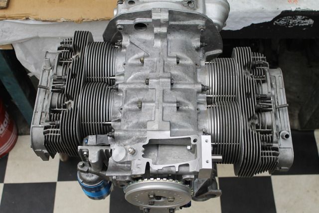

1200 removed and working on the T4T to get it reassembled again:
Re: 1303 Mythbuster -> 1200cc T1T Challenger
It'll look great!!! you'll still have space for the intercooler with the vertical fan system or you planify to change?
and also I have a question that I want to ask you for a while... what is it from the engine that you'll use as a table?
curious to see the result also at the end!!!
fantastic anyway! :thumb:
