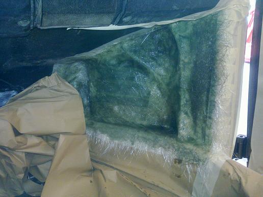

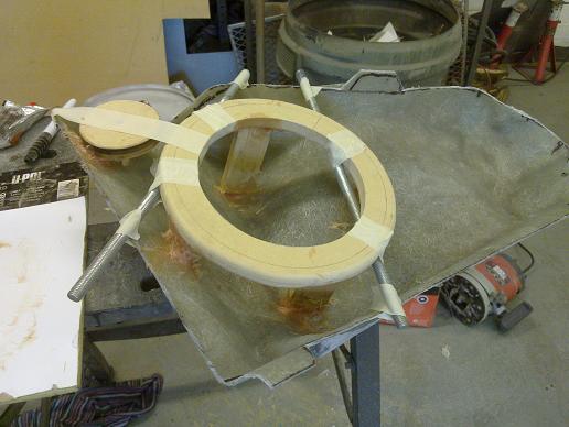

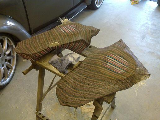

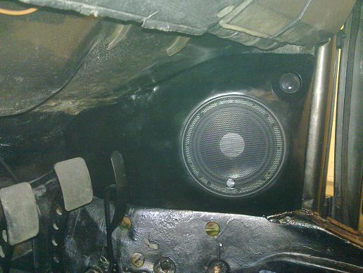

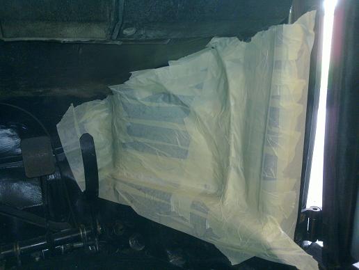

Here you are, I think they are fairly self-explanatory..
Then some body filler..

thanks Ricola !
how are they fixed on the body ?? (where are the screws ?)

If you look at the 3rd and last picture you can see two tabs that I left, these are then used as brackets and screw straight into the body. But, the way it is made to the car they are a very tight fit so don't need much to keep them in place..
