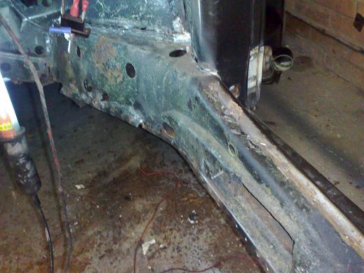

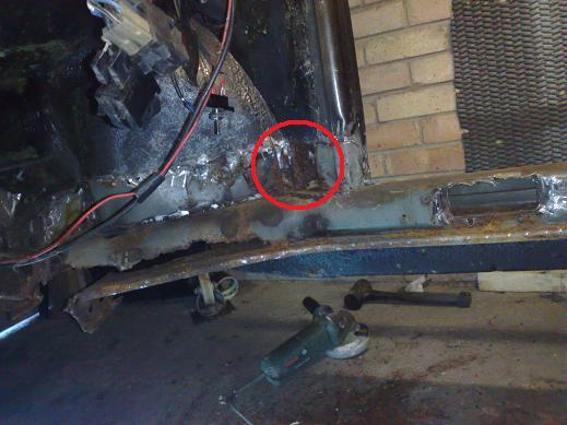

Inside the heater channels, same both sides!

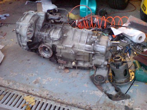

I am also going to use a short nose G50 transmission
It has only done about 30k km and I also have an LSD to go in it.

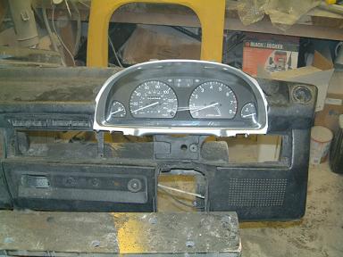

I was originally thinking about modifying the dash for the subaru instruments, but now I am considering using the complete subaru dashboard complete with heating and air conditioning, also moving the steering column so it is less off-centre

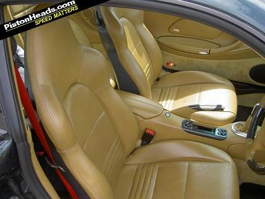

I also have some 996 sports seats:

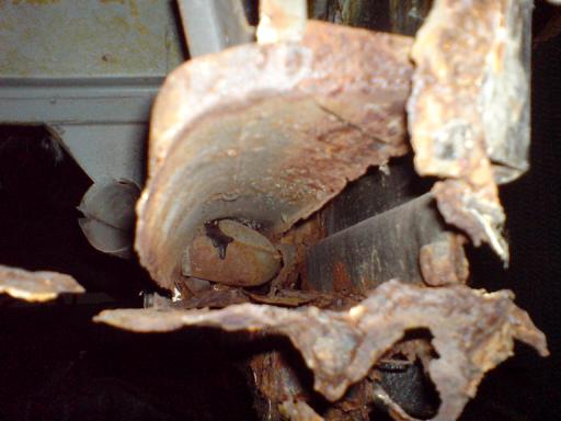

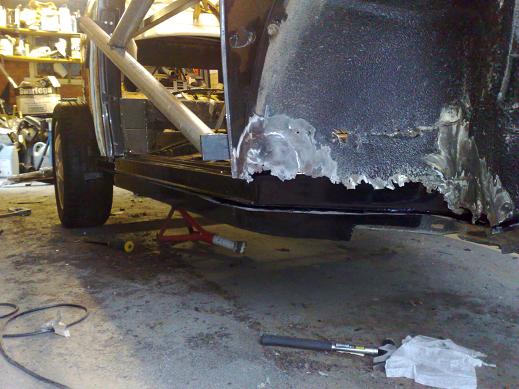

Making some progress and uncovering MORE hidden rust!

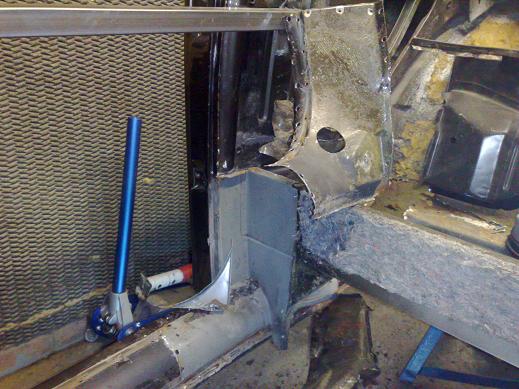

Rear strengthening panels removed:
I need to make a frame to go in the door gap using the hinge bolt positions, then I will cut out the old heater channel and strengthener and start putting new metal in.
There are a LOT of spot welds on this car!

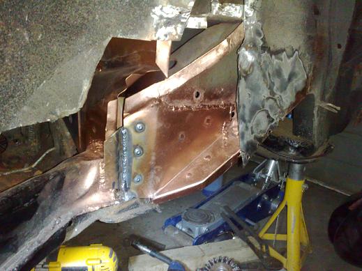

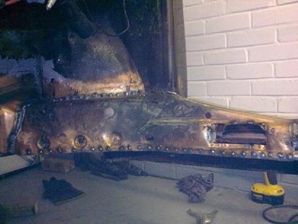

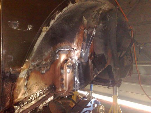

OK, I am well overdue an update, I've been very busy over the last few weeks/months off and on!

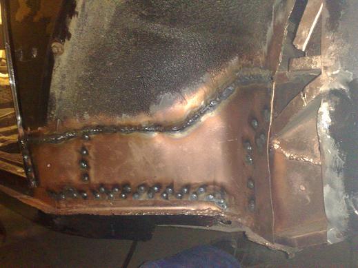

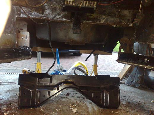

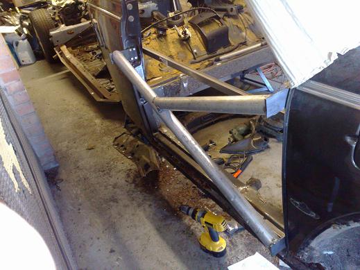

I made up a removable frame to add extra body support while the heater channels were cut out
New channels and strengtheners after being stripped and repainted

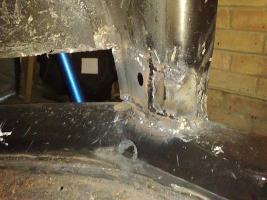

New A post bottoms on both sides
New crossmembers
Image Image
New bulkhead
Image Image

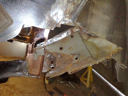

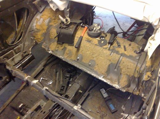

Inner wing strengthening was also rusty...
Image Image

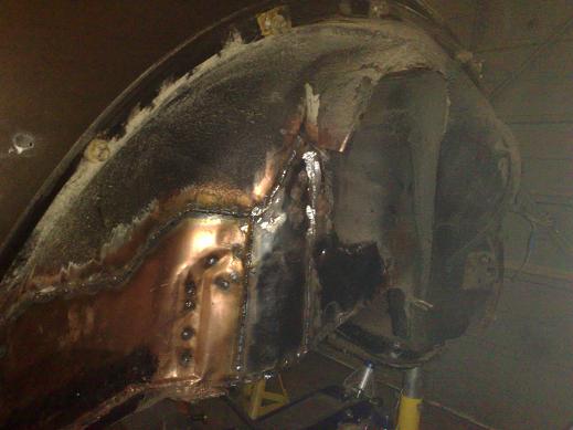

New inner wing
Image Image
That is as far as I have got so far, will hopefully get most of the bodywork finished this weekend :D

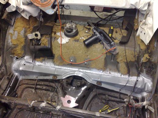

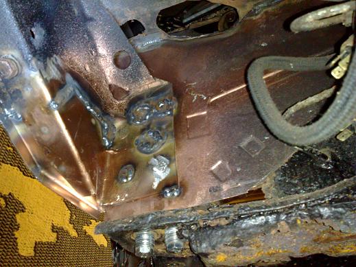

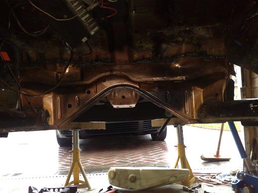

More done today, both spring reinforcing sections replaced...
Just the footwell reinforcement panels to replace and then I will have a solid body!

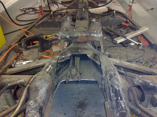

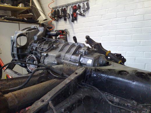

The bulk of the body repair is now done :cheers:

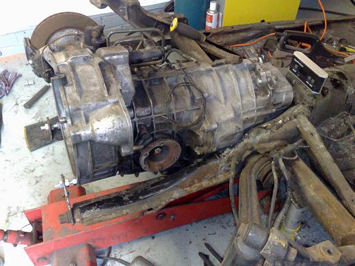

Now for squeezing in the G50...
I have positioned it 25mm higher and about 70mm forwards compared to the standard bug trans to get the subaru engine under the bodywork.
Rich
Re: VWRX 1303 cab
Good job on the body :thumb:
How will you reinforce the rear beam?

Message par ricola »
I had a few different ideas, now the gearbox is in place I can see better what space is available. I will probbaly make a steel U-shaped link underneath the framehorns. I will also make a link going between the damper mounts over the gearbox (either the stock mounts or remade similar to a bus) I am also considering remaking the framehorns as a lot was cut out of the one on the right hand side...
