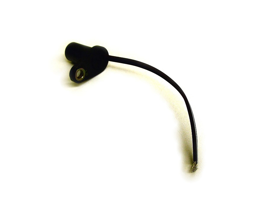

Thanks Walter!
What kind of wheel speed sensor do you run?
Did you play with the tracion control?
- Airspeed
- Messages : 324
- Moteur : 2,4 T4T
- Localisation : Pays-bas
Re: Superflo's 1303
I bought a generic brand with the right voltage and connections (looked exactly like the sensor dta shows on their site). It even fits my 944T spindles in the hole of the abs sensor, but...I can't seem to make it work I welded 4 square pieces of steel on the abs ring so the sensor would read the teeth I made, but nothing yet.
Yes, the wheel sensor was meant for speed read-out in the S60 log (which is VERY complete, you can log litterally anything) and for full traction control (drag starts), but no go yet.
The launch control worked surprisingly well without the speed sensor I must say
Gave a 1.7 sec 60ft time with my 1000kg bug already!
Re: Superflo's 1303
I also have 944T ABS spindles and hubs and I wanted to use the ABS sensor but it's a magnetic sensor and the DTA works with Hall effect wheel sensors.
Where did you find yours?
