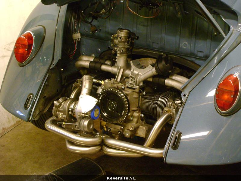

Re: 1200 "Autobahn-Renner" [NL]

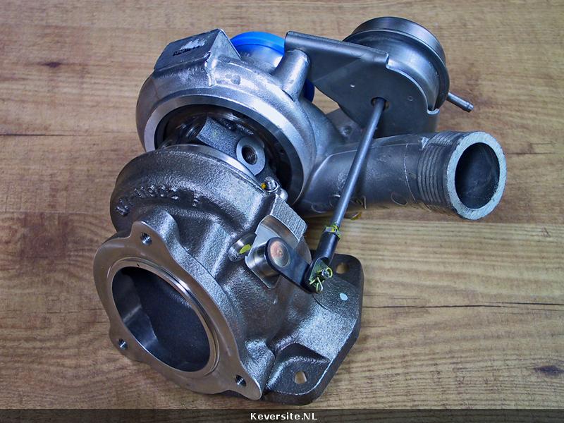

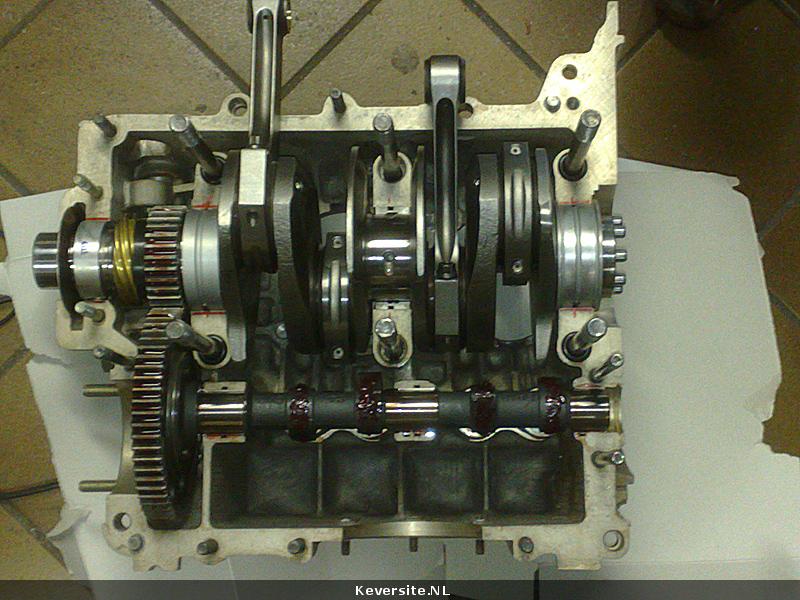

76 x 90.5mm (=1955cc)
5.5" CB Super Race Rods
Webcam 218 avec 112' Lobe Centers

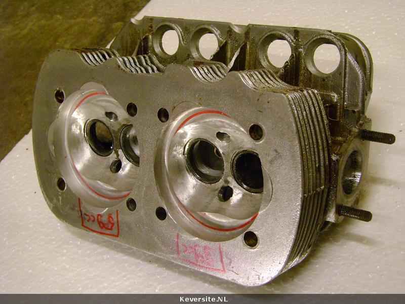

Stock heads, ported and converted to twin plug

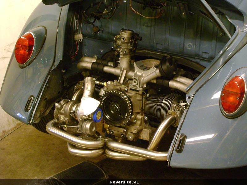

Mexico fuel injection intake manifold
Megasquirt ECU with JAW wideband and EDIS ignition

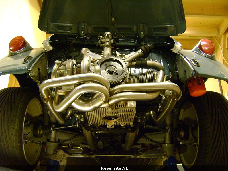

Stainless hideaway turbo header
TD04L-14T turbo (from Volvo S40/S60)
More pictures: http://www.keversite.nl/fotoalbum/my_photos.php?id=4568
Just preparing for some more fun at the Nurburgring next year!!
Quel est vraiment l'intérêt du passage en double bougies par cylindres ?Aart-Jan a écrit : Stock heads, ported and converted to twin plug
- Aart-Jan
- Messages : 19
- Enregistré le : 09 nov. 2007, 12:33
- Localisation : The Netherlands
By igniting the fuel mixture at two locations, the burntime will be shorter (giving less more needed timing advance). By shortening the burntime, not only efficiency increases but available time for detonation also decreases. So besides a more efficient combustion, a higher compression ratio or boost level can be used, giving again more efficiency and power! We will see how this turns out in practice...
At first I will try to use the stock EDIS controller and just wire two sets of coils to it. If that doesn't work properly, I will use four transistors for direct ignition control.
Maybe it will divide the power of the spark, because you share it !Aart-Jan a écrit :and just wire two sets of coils to it
And if your coils hasn't the same impedance, maybe it will not be divided in 2... but a ratio due to it.
Much better I think !Aart-Jan a écrit :I will use four transistors for direct ignition control.
- Aart-Jan
- Messages : 19
No. The coils are permanently connected to +12V and are switched to ground by the EDIS controller. By connecting two EDIS coilpacks to one controller, both coilpacks will be switched to ground at the same time over the same pin. So, you drain more power throught the EDIS controller. The controller is only making the connection. I don't exactly know what is the limit of the internals (transistor) of the EDIS controller (too much power drain can fry the internal transistor), but it's worth the experiment IMHO.
- Messages : 6188
Ok with you ! I've not understood this way at the first time.
I believed that you would connect 2 coils on 1 EDIS output...
I wish it was already finished. Unfortunately, I didn't have much spare time last months, so no further progress on the project.
Some old pictures of the latest progress:
Relocated wastegate actuator
VW TFSI chargecooler core
Hyundai H100 oilcooler
All oil lines received pressed couplings:
