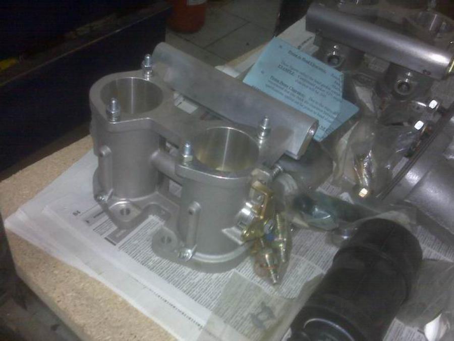

--Body Exterior--
New wings (not modified or bigger)
New running boards painted "Carbon Fiber effect"
New front & rear Bumper painted "Carbon Fiber effect"
Front Headlight rims painted "Carbon Fiber effect"
New HELLA Lights front & rear & white turn signals
--Under Body--
The whole under body was sandblasted and powder coated by expensive epoxy silicon paint (HEMPELS - http://www.hempel.com/) used in the shipping industry. All screws have been changed with new inox ones
--Interior--
OMP Strada bucket seats
Front Schroth black racing harnesses
PORSCHE 944 turbo (rear bucket seat)
Original 1303 dashboard re-upholstered with REAL red leather
Original 1303 speedometer modified in Germany up to 240kmh
STACK instruments (tachometer, oil temp, oil pressure, and voltmeter)
Black anodized custom hydraulic handbrake
Black Momo steering wheel (black leather with red stitching)
Power windows
--Under The Hood--

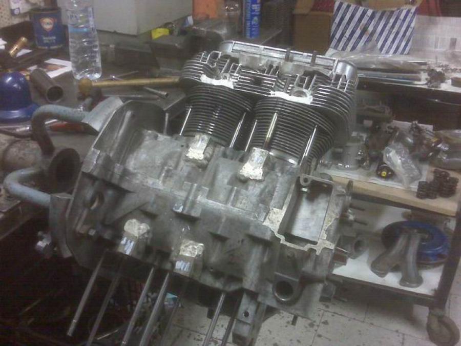

Type IV highly modified crankcase (PORSCHE 914/4-injection) bored to 103mm with ARP 2000 stud kit
SCAT billet chromoly crank 80mm with Chevy rod journal
PAUTER con rods with 3/8 ARP bolts set
JE 103mm piston set + Total seal rings
New 103mm iron cylinders
Highly modified Type IV cylinder heads inlet valves 50mm, exhaust valves 42 mm, compression ratio set @ 11.9:1 -
PAUTER titanium retainers
PAUTER titanium lifters 39 gms with bushes
PORSCHE 11 blade fan from 911-930 turbo + Carbon Fiber effect engine shroud
PAUTER custom special camshaft? (my big secret!!!!)
Weber ALPHA 48mm throttle bodies
HALTECH ECU - http://www.extreme-tuners.com/
Dry Sump
Front mounted oil cooler
PORSCHE 901 dogleg 5 speed
Conversion parts in order to fit the 901 gearbox to the beetle from bugat5speed.de
QUAIFE LSD
PORSCHE 930 shafts
PORSCHE 901/914 215mm flywheel & 230lbs Kennedy clutch cover
PORSCHE 911 single pipe rear muffler with high performance header 4-2-1 all stainless steel

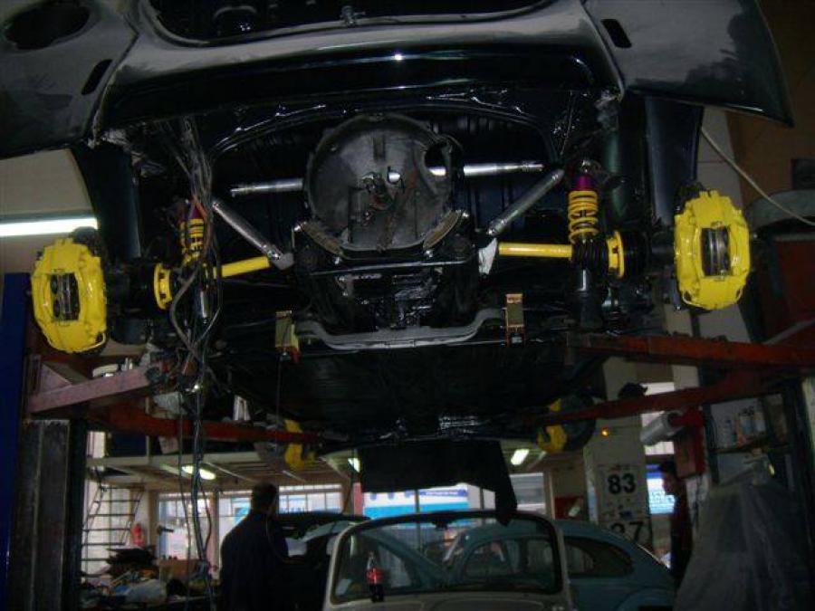

--Suspension--

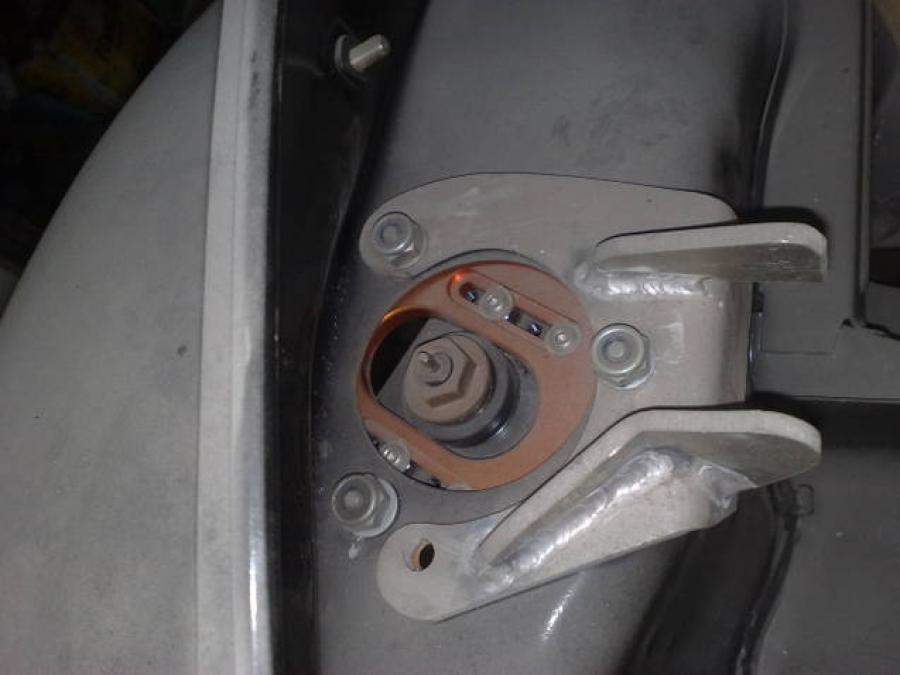

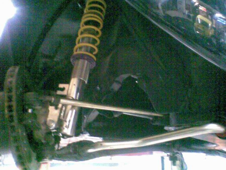

KW variant inox line coilovers all around
Front adjustable top mounts
GWD rear uni ball system
PORSCHE 944 turbo suspension arms
VW 1303 super beetle front lower arms
BILSTEIN steering damper
KERSCHER aluminium front + back anti roll bar
Aluminium Cub brace / torque bar
Aluminium Front strut brace

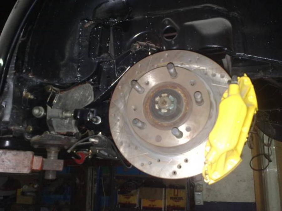

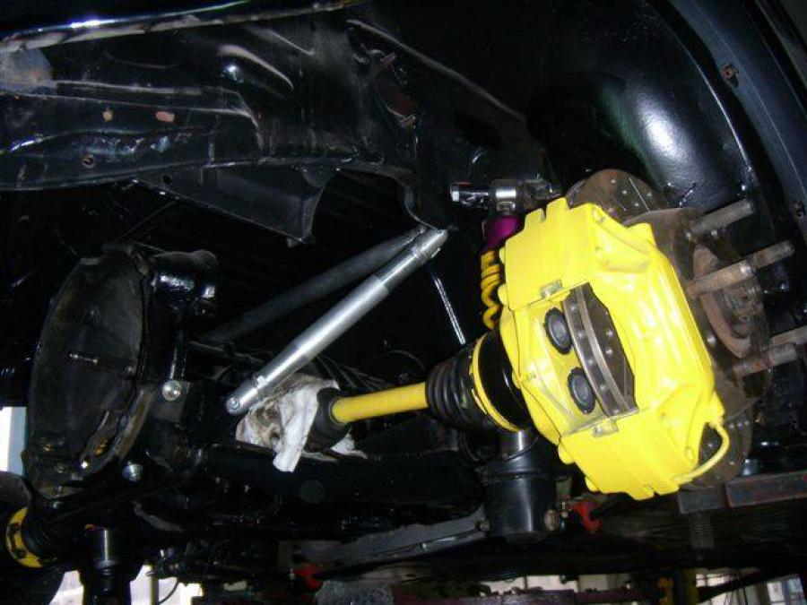

PORSCHE 996 gt2 6 pot front brakes with new discs
PORSCHE 964 Carrera 4 - 4 pot rear brakes with new discs
--Wheels & tyres--
PORSCHE 911 Cup I - 7,5 x 17 "dressed" with brand new Continental tires
--Body Exterior--
--Under Body--
--Interior--
Power windows
--Under The Hood--
Dry Sump
QUAIFE LSD
PORSCHE 930 shafts
--Suspension--
--Wheels & tyres--

Have you lowered the front axle ? I wonder if you face bump steer issue with your front setup ( Kw coilover / 1303 suspension arm / anti-roll bar / 1303 disc spindle ?)

-Suspension has finished and has been fitted on the car needs to be tuned though
-Brakes have finished including handbrake (hydraulic) and have been fitted on the car

-Engine short block, heads, etc have been assembled but not fitted on the car yet (Engine is currently sitting on the bench). We have not fitted the throttle bodies & the ECU. The idea was to originally run the engine for the first 5000km on carbs and then place the ecu with the throttle bodies in order to program them on the dyno. New wiring loom needs to be done. 911 fan has not been fitted, Dry Sump has not been fitted; oil radiator has not been fitted, Oil lines have not been fitted, Oil breather box has not been fitted, Exhaust system has not been fitted.

Do you have the feature to run in closed loop lambda contol with your ecu? I use this with my DTA S60 to get a quick base map.
The car is nice and the powerplant looks promising!
