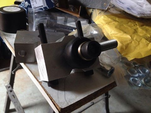

The key part to the swap is creating a forward bracket, this aluminium block spaces the anti-roll bar downwards with the stock saddle clamp and gives plenty of meat to mount the forward joint.
The block fitted, not how it is fitted to the chassis form. My mate, Seb, machined up some tube end fittings for it.

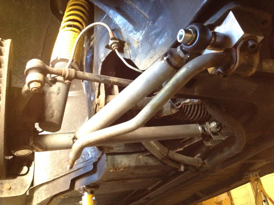

and fitted to the car, now to align the hub and measure up for the tension link. The last bit will be to work out how to connect the anti-roll bar.

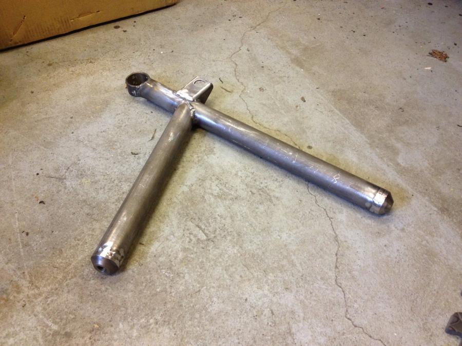

Tension link tacked in at nominal geometry position. Some people will fit a clevis type joint to the lateral part but I only wanted minimal adjustment. Welded will give better stiffness.

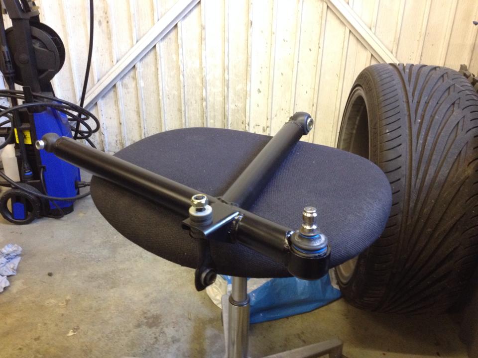

Finished A arm ready for paint

Ball joint pressed in and rod ends adjusted with their rubber boots to give them a bit more life

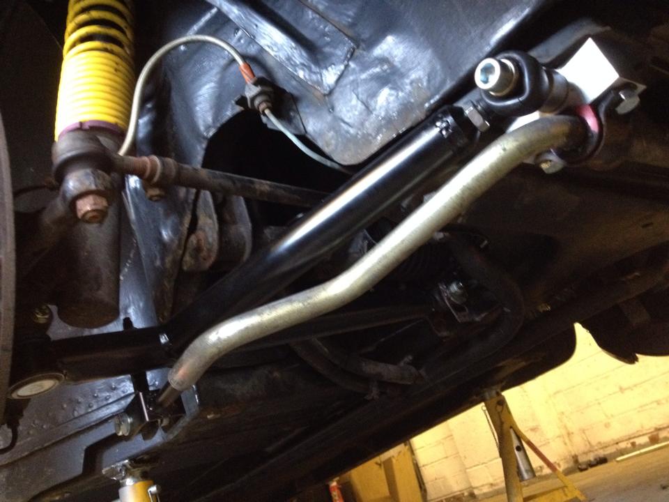

All done!
Closer view of one side..
So, the verdict: in summary well worth it! The front end feels so much more alive and communicative but NVH is hardly affected at all. The tyres seem to work a lot better as they are not moving around so much and the steering is even a bit lighter too. Even on motorways you can feel what's going on with the most subtle of movements. Overall it just gives so much more confidence in what the car i doing and that means a lot!

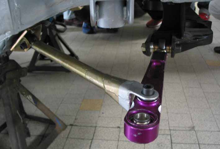

ricola a écrit : Some people will fit a clevis type joint to the lateral part but I only wanted minimal adjustment.
I'm one of those, I think that a clevis type joint would be better, I'm a little concerned with the weld cracking.
Something like this:

That would almost be a 996 front end... I'm not worried at all about the weld cracking, it is a big joint and I prefer that extra stiffness over a clevis, I don't really need the adjustment.
